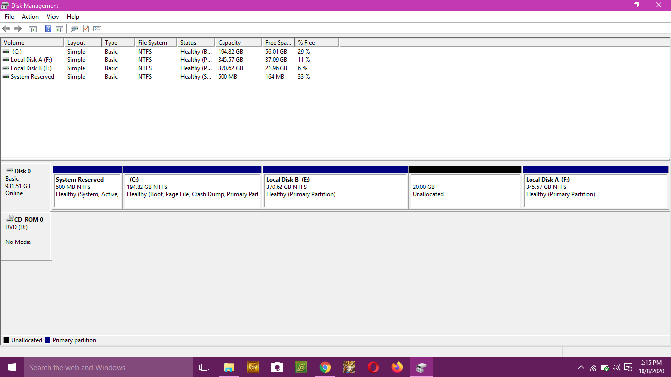

    I am currently trying to dual boot on my laptop. However during installation following error occurs
    Unable to dual boot windows 10 in my HP Laptop [​IMG]

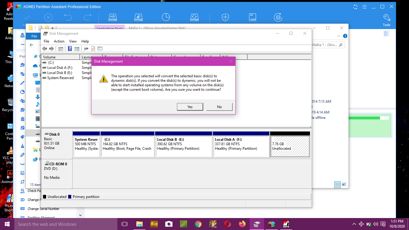

    I am also unable to create the new volume in the disk management system. Disk volume property is MBR. Also I don't have 4 partition as specified in the MBR property. If I try to create new volume by shrinking the volume following error appears...
    Unable to dual boot windows 10 in my HP Laptop 5442addb-6d70-49f1-a51c-b45e2a3195e1?upload=true.png
    Unable to dual boot windows 10 in my HP Laptop 6c89a5b2-3e8b-4f9d-9929-4b12db07fa7a?upload=true.png
