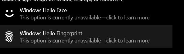

    Recently purchased Dell Inspiron 5593, I am unable to set up windows hello face and fingerprint. It says " We couldn't find a camera compatible with windows hello face.
    Unable to set up windows hello face and fingerprint. 945f6b79-18a6-4aa6-86db-1808ce15ccff?upload=true.png
    Manish ReddyOK, Jan 1, 2020
