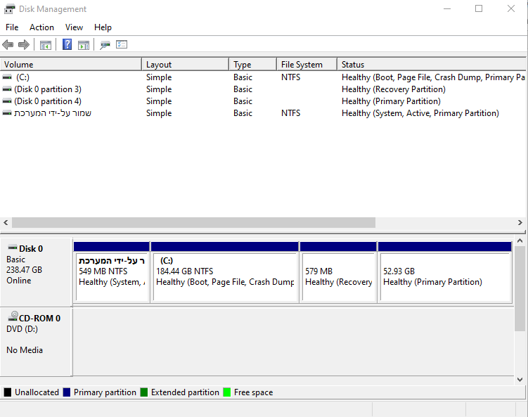

    My computer came with a dual boot 1 to Xubuntu and the other to Windows 10.
    I want to remove and uninstall the Xubuntu partition, so I looked in the Disk Management and I see that there's a 184GB, 2 500MB partitions and another that is 53GB. To remove the Ubuntu do I just remove the 53GB partition?
    Thanks, ofido.
    Uninstalling an OS from a partition? cace5b67-a0ab-474f-9718-24eca3db2760?upload=true.png
    ofido, Apr 15, 2020

  4. topgundcp Win User
    Uninstall problem
    Open the Admin Command Prompt:
    1. diskpart
    2. List disk
    3. select disk # where # is the disk that contains hidden partitions
    4. list par
    5. select partition #
    6. delete partition OVERRIDE
    7. repeat steps 5 & 6 for the additional hidden partitions.
    8. exit
    OR:
    if you want to clean the whole disk, after step 3 above
    Type: clean
    Type: exit
    topgundcp, Apr 15, 2020
