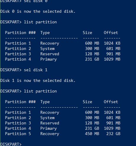

    It looks that my system split/migration from one SSD to a new SSD left an EFI partition on the source, now secondary disk (D). This disk contains all libraries like My Documents. Updates failed ever since I have added that drive. I have added an M.2 drive for all system files using a data migration tool by Samsung
    I have already tried to
    • Reset all registry, file and service permissions ( in safe mode) - what have I missed?
    • Rename/remove/recreate Catroot & download folders
    • browse though all the log files I could find in Panther folders
    • Tried to repair with Media Creation Tool for 1803/1809 - same failure
    Request for advice
    Need advice if this indeed is the root-of-all-evil (as suggested here), and advice on follow up, i.e. how to check & "safely" remove this EFI partition from my secondary (D-)drive. My C-drive contains all windows system files. Can I perhaps test by unmounting D?
    Both disks are 250GB SSD, Disk 0 is on a M.2
    my partitions look like
    Update database corruption, my findings so far, Need advice on options 6440a6e7-0154-4975-acdf-18061a913cc2?upload=true.jpg
    help is appreciated
