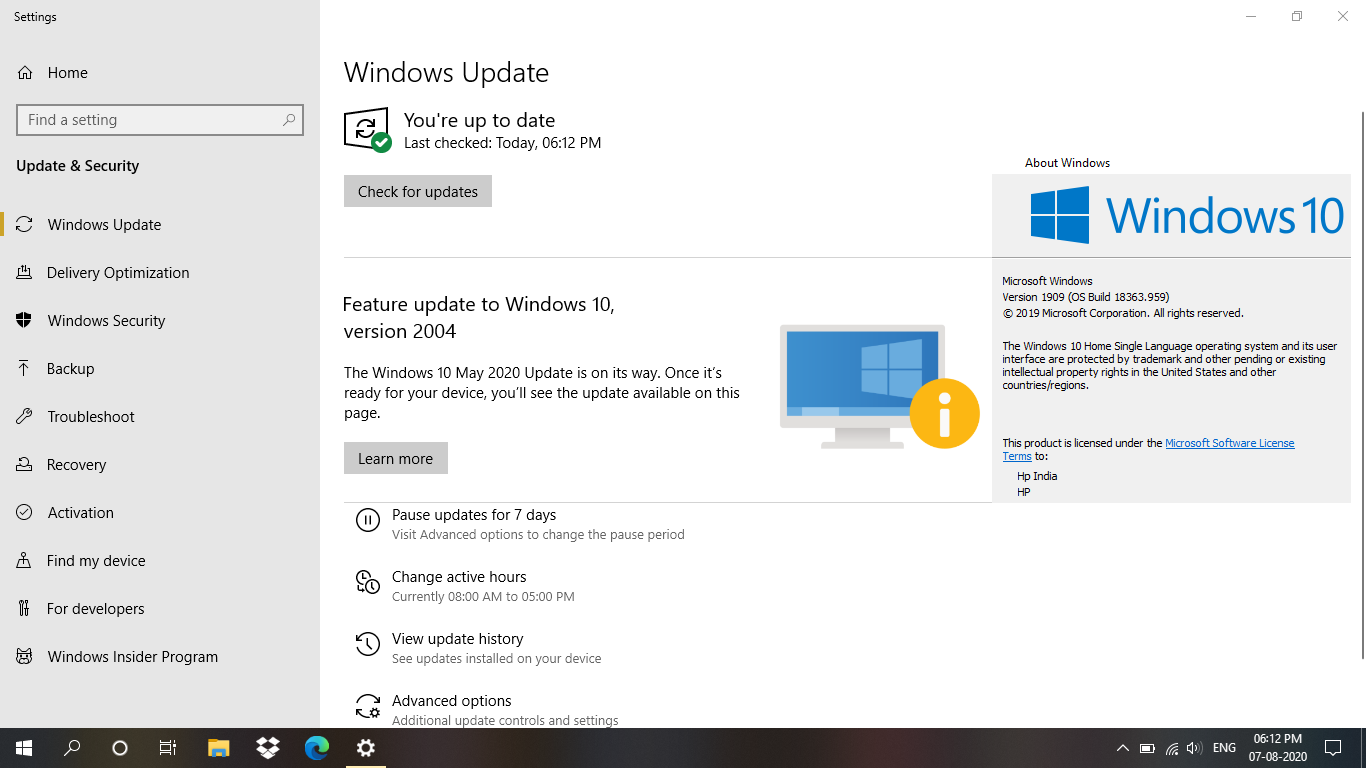

    Hi, this is Gavin. Currently using Laptop HP 14-am 090TU, along with Windows 10 OS Version 1909 (OS Build 18363.959).
    Just came to know that Microsoft has launched New Version "2004" for Windows 10 OS. But currently when i check for updates through Windows Updates it shows me message i.e "You're up to date. Last checked: Today, 06:12 PM {As Shared Screen Shot below}".
    Means i am not able to get or the is not available for My Laptop i.e Latest Windows 10 OS Version "2004".
    Do i need to wait a longer for My Laptop to get Windows 10 OS Version "2004" update or can i download it through Microsoft Support Website.
    Please help me in getting the New Windows 10 OS Version "2004" update.
    Thanks & Regards,
    Gavin
    Windows Updates (Screen Shot) **
