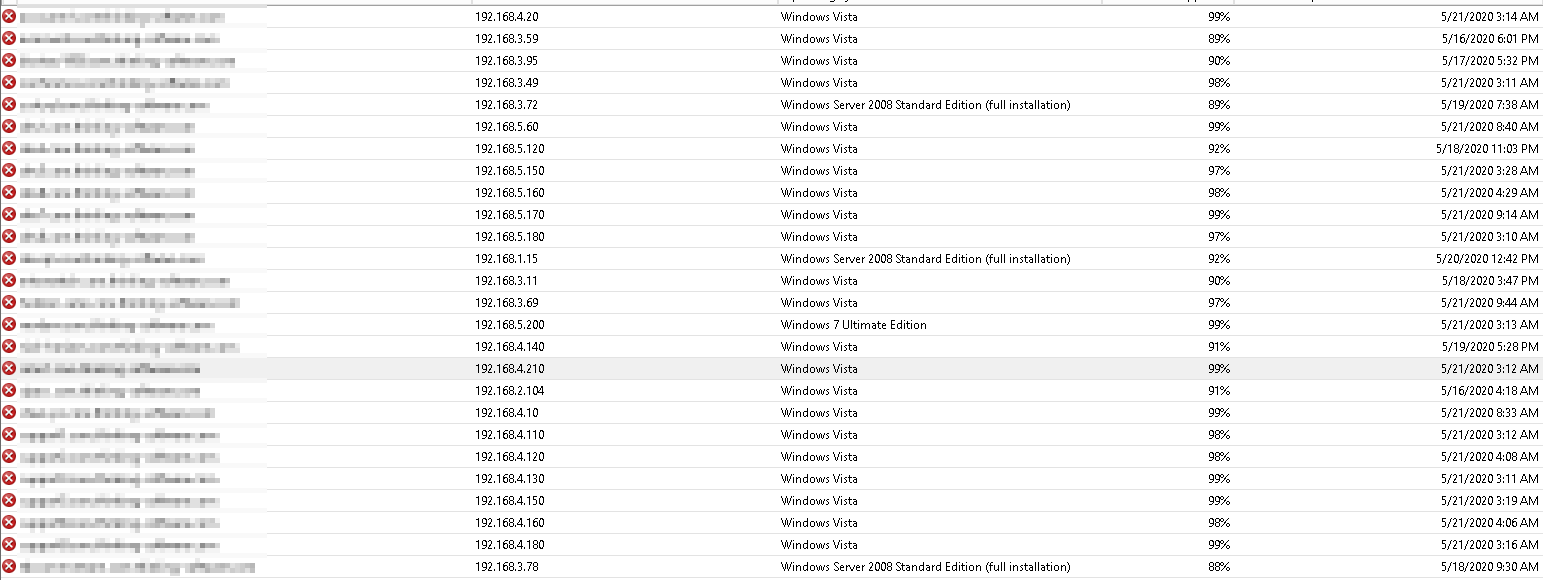

    If I take one computer for example:
    It is currently running Windows 10 Pro 10.0 18362/1903 and I'm trying to get it and all the computers on our domain to upgrade to 1909.

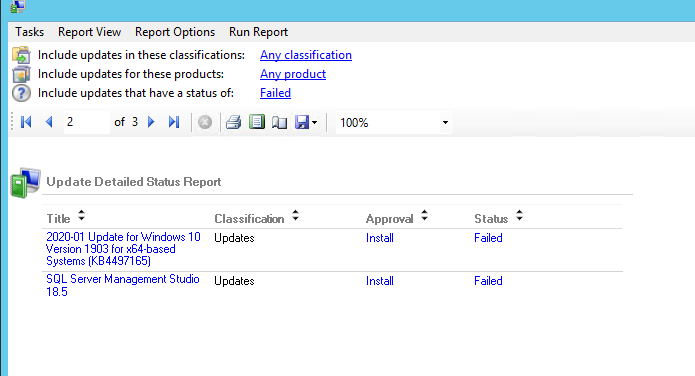

    These are the updates it's failing on:
    Updates from WSUS failing to download to clients 762c4211-f674-47cb-aa8d-531c9dc9e0d2?upload=true.png
    The reason it failed is vague. "Error: Download failed."
