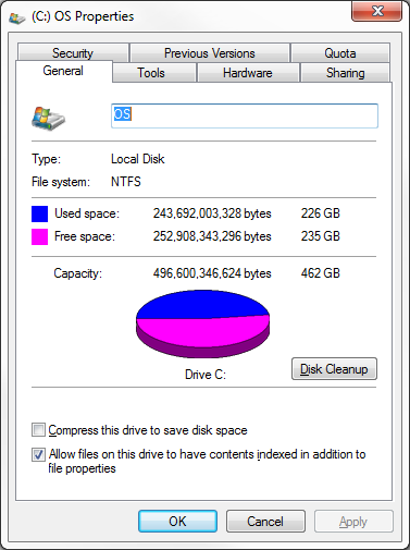

    Here's the 500GB SSD drive on my work laptop. There's some data on it, but only on the order of roughly 50Gb:
    Sasqui, Dec 4, 2019
