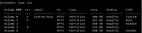

    diskpart - Updated all of my volumes to the correct settings least I think I did

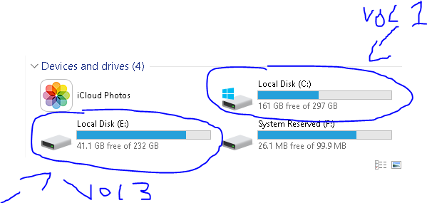

    • This is a gaming PC I built a few years back. It has two main storage drives
      • C drive - All my current games/files/pics etc
      • E drive - All my old files/pics from my old computer
    • I can actually run windows 10 on my 4th volume which contains an older version of windows 10 + all my old files/pics - E-drive?
    • Getting this error message when I attempt to start my PC on my primary volume which I use.

    URGENT: 0xc0000001 - "...the operating system on your PC has failed to start...." 5bd4f22f-45ab-45d8-aac7-caf62745f9b5?upload=true.png
    URGENT: 0xc0000001 - "...the operating system on your PC has failed to start...." cca950f0-466e-485c-b914-728c77914d6f?upload=true.png
