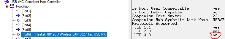

    One interesting thing comes from the usbview program. Notice that "Supported Protocols" is NO for 3.0:
    USB 3.0 device with message "Device can perform faster when connected to USB 3.0" a951408e-880a-483b-9011-b2e4193f40d9?upload=true.png

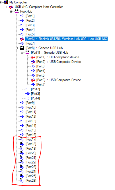

    Also, all the USB 3.0 ports circled in red don't appear to be connected:
    USB 3.0 device with message "Device can perform faster when connected to USB 3.0" 3afff004-3ee3-4e44-8d18-84319f9ccdee?upload=true.png
