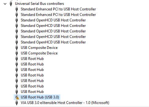

    So I have Acer WMR headset and it had been working for a long time now, than a few weeks ago it started booting up staying up for a few minutes then crashing and rebooting giving a check USB error, than about a week ago it just stopped coming on and now everytime I plug it in my USB root hub 3.0 gives an error.
    USB 3.0 giving error 43 when plugging in WMR 4b7d1766-1812-4d78-9f2c-1b143db1fb87?upload=true.png

    I have done just about everything, reinstalled all the Drivers more than once, updated Windows, reset my PC, uninstalling and reinstalling than restarting. The USB works fine when I don't have my headset plugged in and my WMR works Just not detecting the 3.0 ports when I use the driver given by my motherboard manufacturer Gigabyte. WMR says I cant run it, I just wanna know if I have to scrap the headset or not, or if there is any way to fix this.
