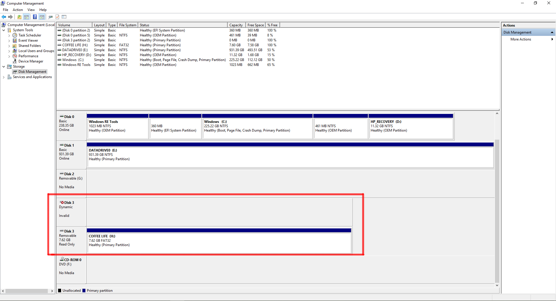

    Somehow my usb key is both invalid and read only after copying some pictures on it from a mac, and displays as two disks with the same number.
    I've tried using diskpart and regedit to take the write protect off, but it hasn't been working. I've also tried right clicking on the disk but the only thing that isn't grayed out is "offline" "properties" that says that the USB is working properly and "help".
    I'd like to know what I can do to get the key to function properly again?
    I don't care about retrieving the files on the key, there's nothing important on it as it was pretty much brand new, I just want to retrieve the key.
    Thank you!
    USB both invalid and write protected 8fb71f15-bdaa-4c0c-879b-6cbda9e87da7?upload=true.jpg
    Luleez, May 25, 2019

  4. Fernandz Win User
    How To Format A Write Protected Flash Memory ?
    ¿You already tried this one?...
    Run CMD
    1. diskpart
    2. list disk
    Then in the 3º step, put the correct number of disk in the list for the usb flash (if it's listed in disk 3, then you'll have to write select disk 3).
    2. select disk #
    3. clean
    4. create partition primary
    5. select partition 1
    6. active
    7. format fs=fat32
    8. assign
    9. exit
    with that commands you will format the flash drive in fat32, if you have a large drive you can select also "format fs=ntfs" in step 7.
    good luck!
