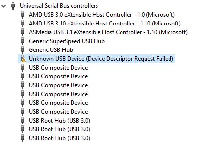

    Okay, i have tried my best to find a solution to this problem, but so far, no luck.
    i have a Rode USB microphone, that i have been using for a while now.
    However, since a few days, at random times windows says "usb device malfunctioned and windows does not recognize it" and the microphone is no longer seen as an audio device (however, the light on it still works, so it gets power) .
    Sometimes reconnecting it works, but often not. it than refuses to work for hours or days even.
    restarting the computer does nothing.
    updating the USB driver through device manager, or deleting the driver and restarting, did nothing.
    using the troubleshooting windows feature, didn't fix it either. it detects the problem, but can't fix it.
    in device manager i can see the usb port saying:
    "Windows has stopped this device because it has reported problems. (Code 43)
    A request for the USB device descriptor failed."
    However, the microphone does work on another PC. i tried different USB ports on my main PC, but still no luck.
    USB device malfunctioned and windows does not recognize it. please help. b2a3b613-cb9b-4931-ba09-0307eab91099?upload=true.jpg
    I tried updating all drivers one by one on the universal serial bus controllers, did nothing.
    could this somehow be a microphone problem? ( which i doubt, since it worked before, and works on another computer )
    how else to fix this on Windows 10 pro 64-bit?
