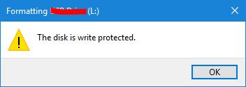

  1. USB drive is write protected; unable to format

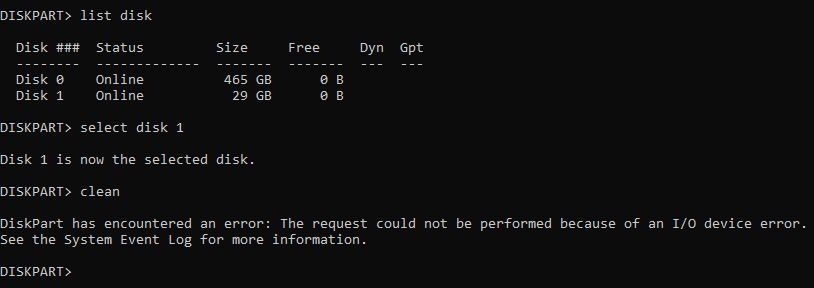

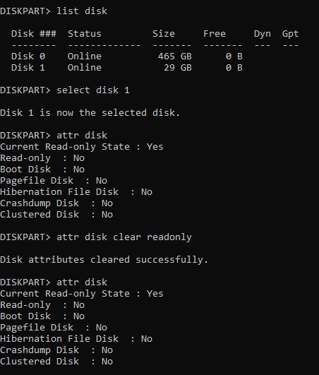

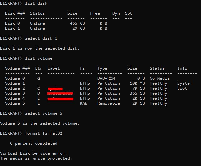

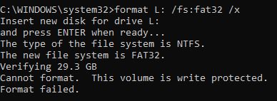

    I had a USB pendrive with some data in it. I accidently plugged out my pendrive while the files within it were being deleted. Ever since then, my pendrive has got write protected. It even stopped showing the storage capacity in the Windows Explorer. I checked the details of the drive using diskpart and came to know that it is RAW file system. I tried formatting the drive using Windows Explorer, Command Prompt and third-party softwares. I even tried modifying the registry values via Registry Editor but nothing came handy. I tried every possible methods but none could solve the problem. Is there any certain way to fix this problem?
    P.S. Screenshots below in chronological order.
    USB drive is write protected; unable to format 724281e3-a177-4812-8452-2f64c246b1f4?upload=true.jpg
    USB drive is write protected; unable to format 6d13396e-1d3d-4a90-b3ad-4046339b7e7f?upload=true.jpg
    USB drive is write protected; unable to format be85ae19-c119-40d6-bf06-ef9f420c7724?upload=true.jpg
    USB drive is write protected; unable to format 211cf841-e3ad-4a69-b7a7-f071d048a694?upload=true.jpg
    USB drive is write protected; unable to format d9cc428a-64d4-4cc2-bb28-3a8abad4fd6e?upload=true.jpg
    USB drive is write protected; unable to format cba92c96-1db5-465a-97a0-f505d549021c?upload=true.jpg

  2. freebird_9924, Mar 7, 2019
  3. Fernandz Win User
    How To Format A Write Protected Flash Memory ?
    ¿You already tried this one?...
    Run CMD
    1. diskpart
    2. list disk
    Then in the 3º step, put the correct number of disk in the list for the usb flash (if it's listed in disk 3, then you'll have to write select disk 3).
    2. select disk #
    3. clean
    4. create partition primary
    5. select partition 1
    6. active
    7. format fs=fat32
    8. assign
    9. exit
    with that commands you will format the flash drive in fat32, if you have a large drive you can select also "format fs=ntfs" in step 7.
    good luck!

  4. Sher Amo Win User
    USB devices getting write protected
    Hi Imdad,
    Some removable storage devices like USB flash drives or pen drive have write protection which is designed to help users prevent unexpected data loss by refusing to delete or format.
    However, if you’re stuck with a write-protected USB drive that can’t be formatted. We recommend that you follow these steps on how to erase and format a write-protected USB flash drive and pen drive using the Regedit.exe tool in Windows. To do this,
    follow the steps below:
    • In the Search box, type regedit and press Enter.
    • Navigate to the following folder:
      Computer\HKEY_LOCAL_MACHINE\SYSTEM\CurrentControlSet\Control\StorageDevicePolicies
    Double-click on the WriteProtect value in the right-hand pane of Regedit.exe. Change the Value data from 1 to 0 and click OK to save the change. Close Regedit and restart your computer. Connect your USB flash drive or pen drive again, and you should find the
    write protection is removed and the device is no longer write protected.
    Important: This section, method, or task contains steps that tell you how to modify the registry. However, serious problems might occur if you modify the registry incorrectly. Therefore, make sure that you follow these steps carefully. For added protection,
    back up the registry before you modify it. Then, you can restore the registry if a problem occurs. For more information about how to back up and restore the registry, refer to the following Microsoft Knowledge Base article.
    How to back up and restore the registry in Windows https://support.microsoft.com/en-us/kb/322756.
    Sher Amo, Mar 7, 2019
