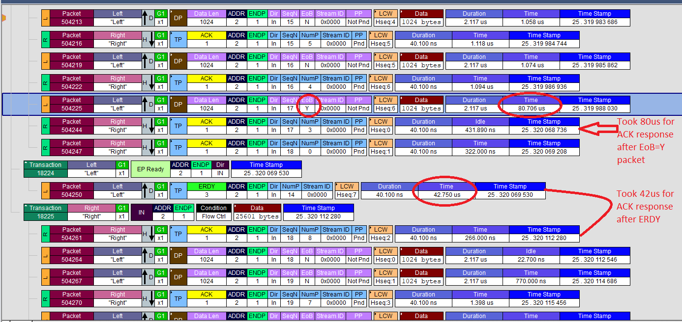

    USB device when connected to a thunderbolt port, we can see a difference in the behaviour compared to a regular type-c or USB port.
    USB IN transfers Host reads and sends ACK back to device are happening in bursts. Each burst is about 8 1024 bytes transfer. The last packet in the burst will have EoB set to 1 indicates the end of burst.
    The difference here is, on a regular Type-C/USB3 port, the ACK response from the host happens very fast less than 2.5us. However on a thunderbolt port, the ACK for the last packet with EoB set is acknowledged very late about 80us delay. This is, in fact, a violation of tHostAckResponse timer in the USB spec. Also, this is causing a performance issue as the device cannot start next transfer even when the next burst is ready as ACK for the previous packet is not received.
