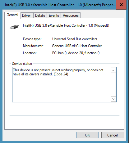

Windows 10: USB ports are not detecting any devices. tried updating the drivers.
Discus and support USB ports are not detecting any devices. tried updating the drivers. in Windows 10 Drivers and Hardware to solve the problem; [ATTACH] The driver says its updated but it fails to detect any device. Could this be a hardware issue? When I plug in phones it charges but the... Discussion in 'Windows 10 Drivers and Hardware' started by RahulAS, Sep 6, 2019.

  2. spapakons Win User
    USB Port Oddities
    Ok, let's see it with pictures step-by-step. First right-click on the USB device and select Update driver software:
    USB ports are not detecting any devices. tried updating the drivers. [​IMG]
    Then select Browse my computer for driver software (LAST option) :
    The select Let me pick from a list of device drivers on my computer (LAST option) :
    Then select the standard driver from the list and click next:
    Click next/OK as required to complete installation. Repeat the steps for all Intel USB devices. Finally click on each USB root device and press DEL to delete it, reply YES when asked. After deleting all USB root devices restart the computer.

  4. SVLingam Win User
    My Seagate external hard drive is not detected when plugged in to USB port of my laptop using windows 10?
    Thanks for your response.
    I have tried all the steps provided, however in vain. The external hard drive is not identified at all in any of the the USB ports when connected. The USB ports identify other external Flash drives and devices. However this drive is detected in another laptop
    using Windows 7 OS. Please advise further.
    Regards
    SVLingam, Sep 6, 2019
