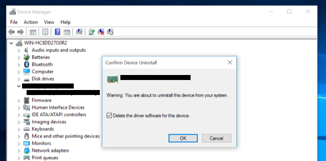

    Here's what I can suggest for you to have the IEEE-1284 uninstalled. Kindly follow the instructions below:
    • Right click on Start Menu.
    • Click Device Manager.
    • Find and select the IEEE-1284 (Parallel)-USB Adapter.
    • Right click the native driver adapter and select Uninstall.
    • Check the box that says "Delete the driver software for this device".
    This should help in removing the said driver.
    Let us know how it goes.
