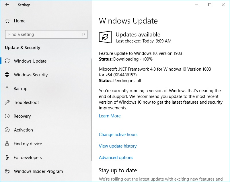

    5. Update Windows - I checked yesterday and it said I was up to date, but they recommend v1903. Today I rechecked and this time it downloaded and now I see this:
    UserProfileCreationFailureDuringFinalize ae9f682d-5043-41b4-ad85-3e237967fff9?upload=true.jpg
    So it apparently downloaded and is now Pending install??? It hasn't asked me to start that yet and I'm not going to do anything to start it. I did go to the Microsoft Website and I downloaded the Standalone Package. So I have that file on my C:\Users\v015e\Downloads\
    folder now.

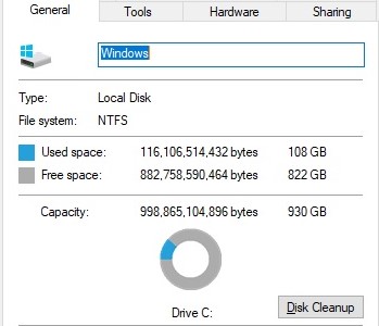

    9. Verify Disk Space - I have plenty
    UserProfileCreationFailureDuringFinalize 49947b4c-0413-407e-89b5-bf4cb1f9e5d4?upload=true.jpg
