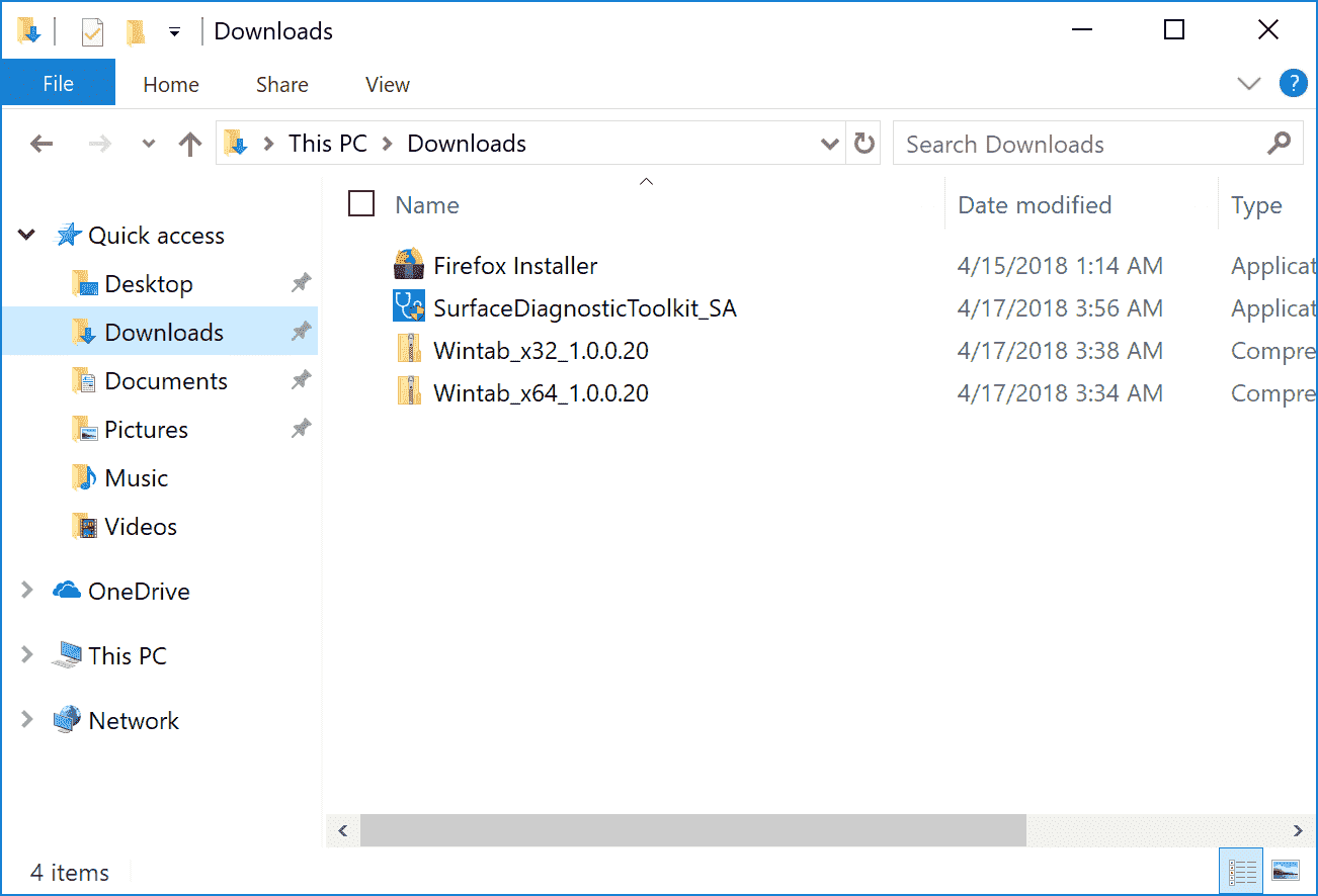

    • Open your File Explorer.
    • The folders under Quick access on the left pane, namely Desktop, Downloads, Documents, Pictures, Music, and Videos are situated in
      C:\Users\<username> by default. Right-click on one of the folders (we'll go for Download this time) and select
      Properties.

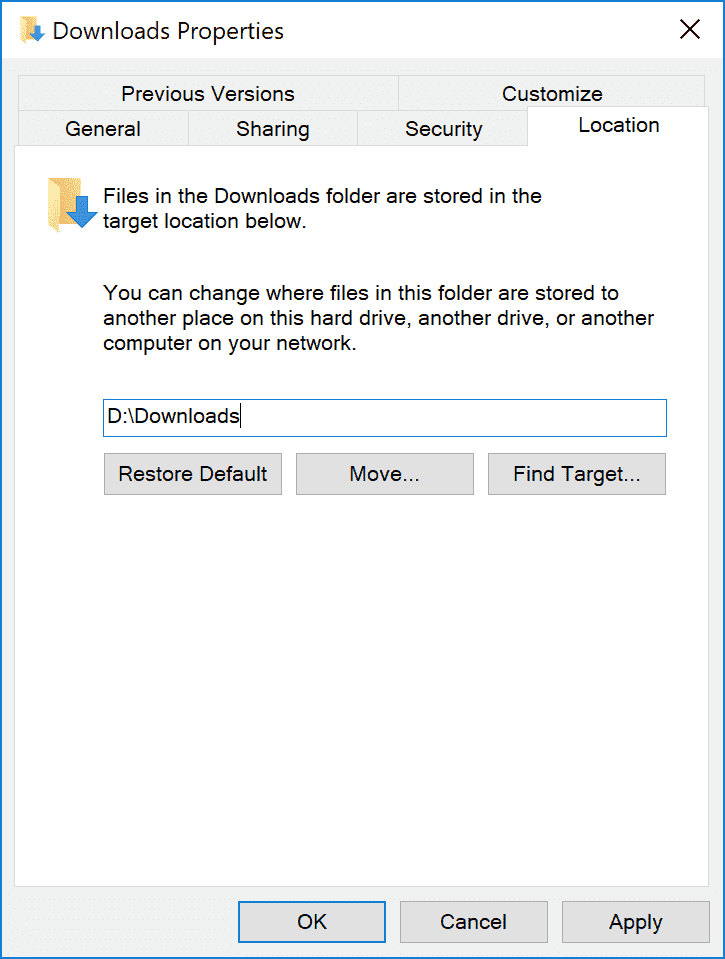

      Using/understanding junctions and links 12f708e9-5c57-49e1-ab5b-b08c0f6a3a4c?upload=true.png
    • Go to Location tab, enter your desired location or select
      Find Target
      , and click OK.
      Using/understanding junctions and links 4b4c95c8-e12e-4664-9307-25c79f17c385?upload=true.png
    • Repeat the process on the remaining folders if desired.
    Let us know how it goes.
