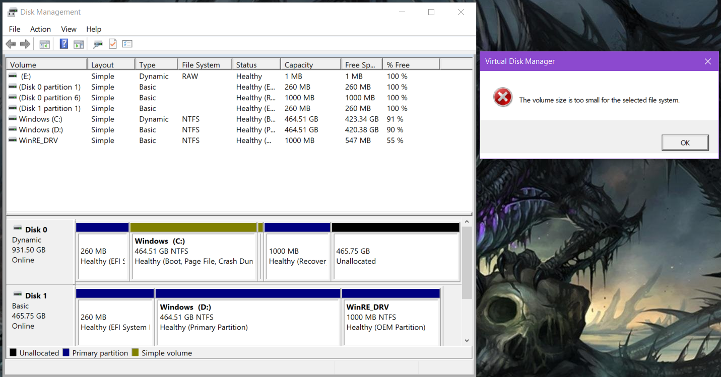

    i just upgraded to a samsung ssd on my lenovo t580. when i try to create a new simple volume it gives me this error. (disk 1 is my old hdd plugged in through a usb cable). i would prefer to merge the unallocated space with the C: drive, but that does not appear to be possible without the use of other software. virtual disk manager 1df8a763-8e57-4774-bf2a-7ad8c4c25bf1?upload=true.png

    Disk Management
    Hi Keith,
    Thanks for providing the detail that was requested previously. Since the disk management screen that you saw is showing greyed out options, we suggest that you follow the steps below to change the partition type of your internal drive:
    • Open Disk Management then right click the partition on the disk you want to covert and select Delete Volume.
    • Once you complete the process you will see the whole disk shown as two separate unallocated spaces. Right-click the disk and select Convert to GPT disk.
    After the conversion, you will be able to use the whole disk and then you can create new separate partitions.
    We look forward to your response to our queries.
    Jordan Dom, Feb 4, 2019
