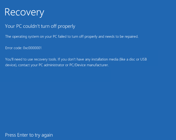

    Hi MS support,
    I would appreciate if you can help me investigate this problem. I've been using Google to get this problem fixed but so far mostly steps I followed don't fix the problem.
    [1] "Restarting" splash screen takes a very long time, I had to force shutdown the VM then start back
    [2] Logging Windows takes longer time, hang at "Windows logo screen black screen" then the following screen appear. If I am lucky Press F8 will load the Windows properly otherwise it will restart again by itself. I have used similar VMs in multiple environments but the result is the same.
    Virtual machines takes longer time at "restarting" and upon startup stuck at "Windows Recovery" e4e07e31-6c56-4d11-ac12-72357b862b9c?upload=true.png
    I have randomly tried the following to see issue can be fixed:
    Msconfiguration > boot
    - Set to selective startup originally normal startup
    - Set to timeout 30
    Turn off fast startup from gpedit.msc
    Disable Windows update from Services.msc
    Restore the software distribution package - https://www.****/knowledge/windows-10-stuck-on-restarting-try-these-fixes/
    Can you please help? How do I send you the dump file?

    I appreciate your effort on this. I understand how difficult it could be when the computer doesn’t work as it is supposed to, we will look into this for you. Please reply with the following details to assist you with the appropriate troubleshooting
    steps:
    • Which application are you using to create Virtual Machine?
    • Does the issue occur only when launching a Virtual Machine?
    • Have you reinstalled Windows on the computer?
    I have analyzed the dump files shared by you. Since the issue occurs when you launch Virtual Machine, I suggest you to try disabling the VMWare USB Arbitration Service and check if that helps. Please follow the steps mentioned below:
    1. Press Windows key + R, to open
      Run
      dialog box.
    2. Type services.msc and click on
      OK
    3. Look for the VMWare USB Arbitration Service and double click on it to open
      Properties.
    4. Select Disabled from the drop down for
      Startup and Stop the service.
    5. Click on Apply and OK.
    Please reply with the status of the issue, we will be glad to help you further.
