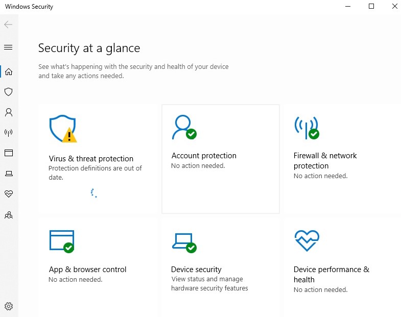

    My virus & threat protection would not update and stated "Protection definitions are out of date."
    Check the Windows Update first and try to download and install all updates first. This did not work for me.
    Virus & threat protection / Windows Defender update failed 1c1ed873-ec04-4e73-ba4f-248bb3db84e8?upload=true.jpg
    Here was my fix that worked for me:
    Complete the Method 1 here:
    FIX: MMC.EXE This app has been blocked for your protection. Solved - wintips.org - Windows Tips & How-tos
    After the reboot setting the UAC back to 1, the Virus & threat protection updated properly and started working again.
