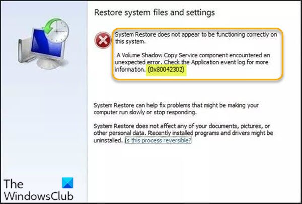

    System Restore allows PC users to restore the OS image to an earlier functioning state. The Restore operation is very easy and doesn’t involve technicalities. However, in some cases, you may receive the error code 0x80042302 when you try to perform a system restore on your Windows 10 device.
    Volume Shadow Copy Service component encountered an unexpected error 0x80042302
    Volume Shadow Copy Service component encountered an unexpected error 0x80042302 System-Restore-error-0x80042302-1.jpg
    When you encounter this issue, you’ll receive the following full error message:
    System Restore does not appear to be functioning correctly on this system.
    A Volume Shadow Copy Service component encountered an unexpected error. Check the Application event log for more information. (0x80042302)
    As you can see on the error prompt, the most common reason for the error is that the Volume Shadow Copy service is disabled.
    In addition, system files missing or corrupted can also trigger this error during the restore operation

    Tried to create a Restore Point today and received the following error:
    "The Restore Point Could Not be Created for the following reason:
    A Volume Shadow Copy Service component encountered an unexpected error. Check the application event log for more information. (0x80042302).
    Volume Shadow Copy
    and Microsoft Software Shadow Copy Provider services are set to "Automatic" and are both running.
    Are there any other services that the System Restore is dependent upon?
