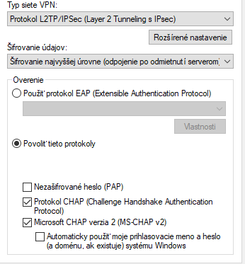

    VPN security setting:
    VPN L2TP error code 809 c6d28ea6-f60b-4897-85fb-509c6dbc11bd?upload=true.png
