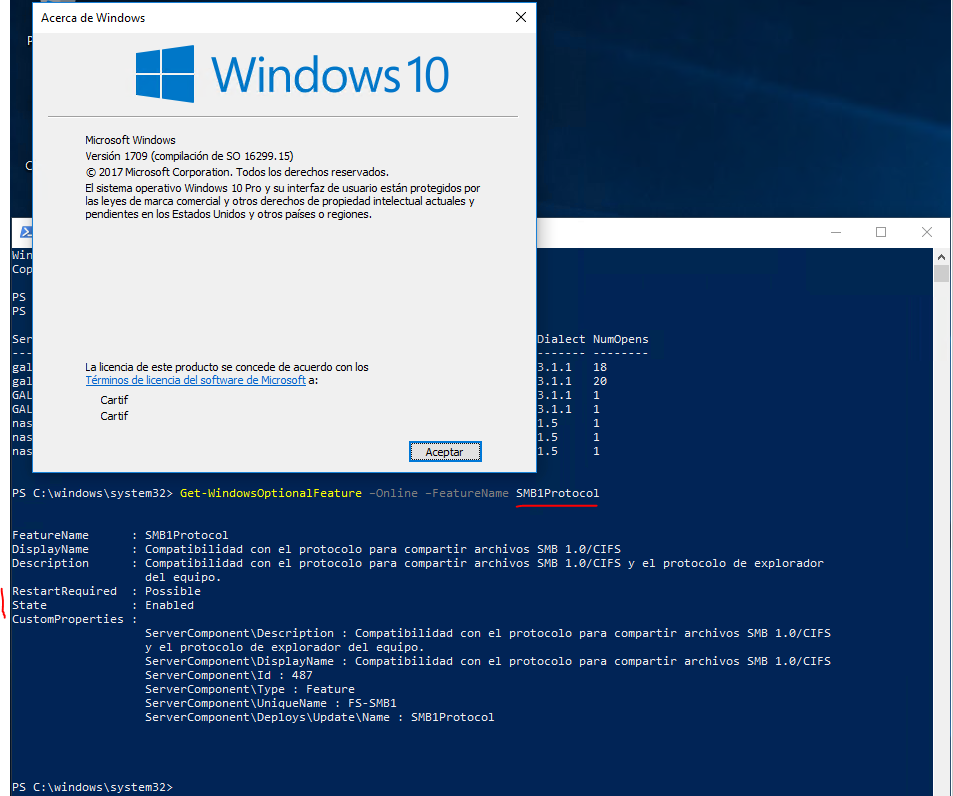

    On October 17 came the new version of Windows 10: Fall Creators Update (RS3). With this update the smbv1 protocol was going to disappear to improve product safety, but yesterday I was surprised.
    I performed a clean installation of RS3 and found that I still had this protocol enabled and could successfully access an old NAS using WS2003. Attached is an image detailing the problem:
    I found the following information in a couple of Internet articles:
    Actually, what Microsoft said is that any new computers or clean OS installations after the release of the Fall update would no longer have SMBv1 installed. But for anyone upgrading from an earlier version that still has SMBv1 installed, it will remain and
    continue to function.
    "This is not patching, nor upgrading," Pyle said. "This is clean install RS3."
    This means Microsoft decision will not affect existing Windows installations, where SMBv1 might be part of a critical system. Users who want to get rid of SMBv1 will still have to manually disable SMBv1 on their existing machines, or perform a clean install
    with Redstone 3.
    So why do I have smbv1 enabled on my new w10 (RS3)?
