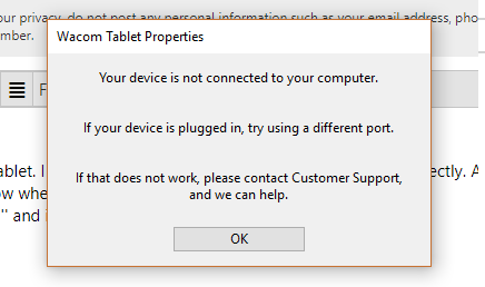

    I recently just bought a Wacom draw tablet. I installed the latest driver and followed all steps correctly. After restarting my computer, nothing happens, no blue light will show when I connect my wacom tablet to the laptop.
    So I go onto ''Wacom tablet properties'' and it says
    even
    though I have connected the wacom to the laptop. I have tried installing and uninstalling the drivers but same thing happens.
    I bought this other wacom tablet and the same thing happened so I refunded it to get this new one.
    I have tried everything, going onto services and stopping and starting the program, searching everywhere but nothing helps.
    On device manager, the wacom tablet doesn't come under anything.It just says ''mouse'' on mice and other pointing devices, it doesn't come under universal serial bus controllers. I am starting to lose hope, and I'm starting to think that my laptop is the

    We appreciate you posting your concern here in the Community forum. In order to help you with your Wacom driver issue, kindly follow the steps suggested below:
    1. Click the Start button from the bottom left portion of the screen.
    2. Once the search field appear, type Services and press
      Enter
    3. In the Services window, scroll down to Wacom Professional Service.
    4. Right-click the Wacom Professional Service and choose
      Start
    If the steps above doesn't help, you may try to uninstall and reinstall the Wacom driver without turning off or disabling the Windows firewall. You may also choose to rollback the Wacom driver if it is working correctly before. Use the following steps:
    1. Press Windows + R on your keyboard.
    2. Type devmgmt.msc and press Enter.
    3. Expand the category you want and right click on the driver and select
      Properties
    4. Navigate to Driver tab and click on Roll Back Driver.
    Let us know the result by replying to this thread.

    These steps worked for me:
    I got them from this article: http://fox-orian.tumblr.com/post/39456072610
    Basic steps:
    • press windows start button
    • type "Services" (don't type the quotes) and press enter
    • in Services window, scroll down to "Wacom Professional Service"
    • right-click the "Wacom Professional Service" and choose "start"
    I hope this helps.
