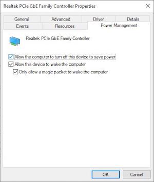

    - On my network adapter Device Manager/Network adapters/Realtek PCIe GbE Family Controller/Properties on the tab "Advanced" I activated ALL the settings, regarding Wake-On-Lan / wake on receiving the magic packet and on the tab "Power Management" it looks like this now:
    Wake-On-Lan does not work 89b3e83f-2d0a-4fc7-867b-0e44979d3d1b?upload=true.jpg

    I think the issue is with my network card, because everytime I put my computer to Sleep or Hibernate or Shut down the network cart turns off the LEDs don't blink anymore and I guess the magic packet never gets the chance to do anything.
