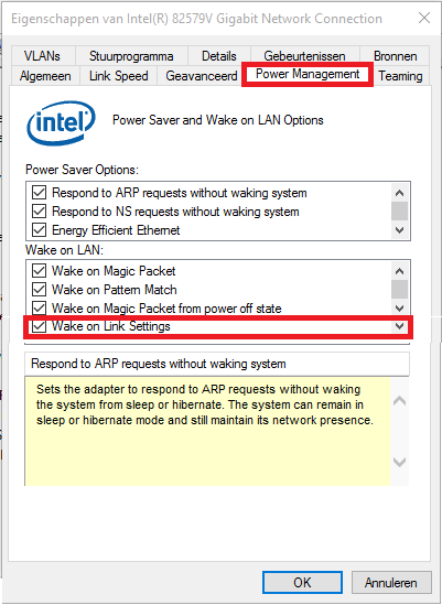

    But that is not true:
    1. Update your driver from the vendor site
    2. If you have the option to enable wake on link you can shut your pc down and wake it by WOL.
    3. Standy and hibernation should work if you apply the settings of Jessen P.
    Wake on LAN WoL Randomly Waking PC During Sleep d3adfe94-ecd4-470b-b1f0-4bf9227d84a4.png
    Hope this helps you or someone else.
