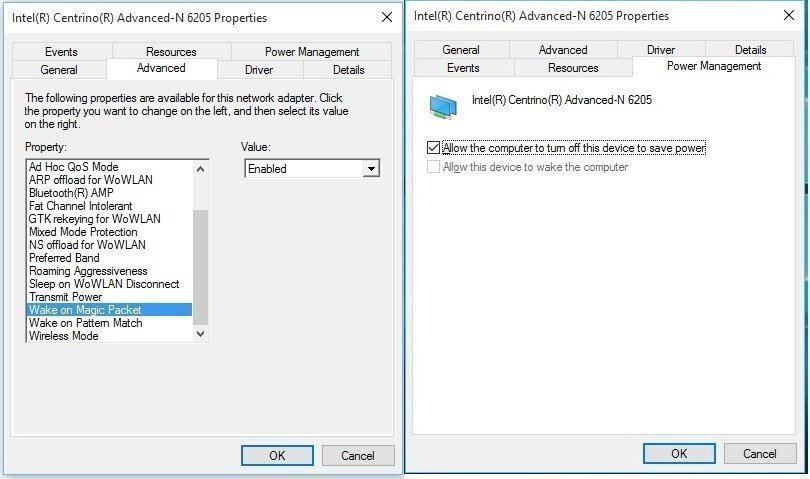

    I have spent a lot of time to search a solution for my issue but I couldn't.
    I have a Lenovo Thinkpad T420s with an Intel Centrino(R) Advanced-N 6205 adapter.
    What I did is:
    Bios checked- settings wake on wireless lan enabled
    Power option - enabled
    cmd as admin and command below done
    powercfg -deviceenablewake "Intel(R) Centrino(R) Advanced-N 6205"
    the result is - You do not have permission to enable or disable device wake.
    I totally don't understand it... why ? I'm admin ...
    REGEDIT key created
    Computer > HKEY_LOCAL_MACHINE > SYSTEM > CurrentControlSet > Services > NativeWifiP > Parameters [EnableWoWLAN (REG_DWORD=0x01)]
    I have also enabled 'Wake on Magic Packet' in the device driver/configuration (see screen capture 1)
    I cannot enable the option 'Allow this device to wake the computer' on the 'Power Management' tab (see screen capture 2). Wake on Wireless LAN windows 10 - Advanced-N 6205 - doesn't work a6ffe22f-27f6-48bf-baf4-6c0dbed7813b.jpg
    Are you able to advise why I have a grey out option?
    Pawel
    Pawel Lukasz, Nov 5, 2018

    Hi Pawel,
    Wake on Wireless LAN is supported on specific OEM platforms only, check with your manufacturer if your system is supported.
    WoWLAN will be disabled if, Intel Active Management technology has the following enabled:
    • Platform has Intel AMT Enabled.
    • AMT is configured to operate in S3.
    • Configured to use Wi-Fi.
    The wireless adaptor and its integration must be validated by the system/motherboard manufacturer.
    Meanwhile I suggest to try with the methods mentioned below.
    Method 1:
    Go to Control panel->power options->Change plan settings->Change advanced power settings.
    Under Sleep, expand allow wake timers and make sure that it is enabled.
    Method 2:
    Update the network drivers and see if it makes any difference. Refer to the instructions mentioned in the link below.
    Update drivers in Windows 10
    Method 3:
    Enable the hidden administrator account and make sure to run command prompt as admin before you execute the command
    powercfg -deviceenablewake "Intel(R) Centrino(R) Advanced-N 6205.
    • Click start, type cmd, right click on cmd
      and select Run as administrator.
    • Type net user administrator /active:yes and press the enter key.
    • Sign in with the built in admin account and see if the command works.
    Hope it helps.
    Peer Samie
    Microsoft Community-Moderator
    Peer_Sam, Nov 7, 2018

    Hi Peer_Sam
    please see below
    Microsoft Windows [Version 10.0.17134.345]
    (c) 2018 Microsoft Corporation. All rights reserved.
    C:\Windows\system32>powercfg -devicequery wake_armed
    Intel(R) 82579LM Gigabit Network Connection
    HID-compliant mouse
    Remote Desktop Mouse Device
    C:\Windows\system32>powercfg -deviceenablewake "Intel(R) Centrino(R) Advanced-N 6205"
    Pawel Lukasz, Nov 7, 2018
