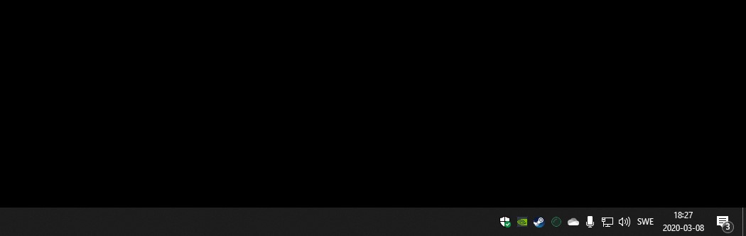

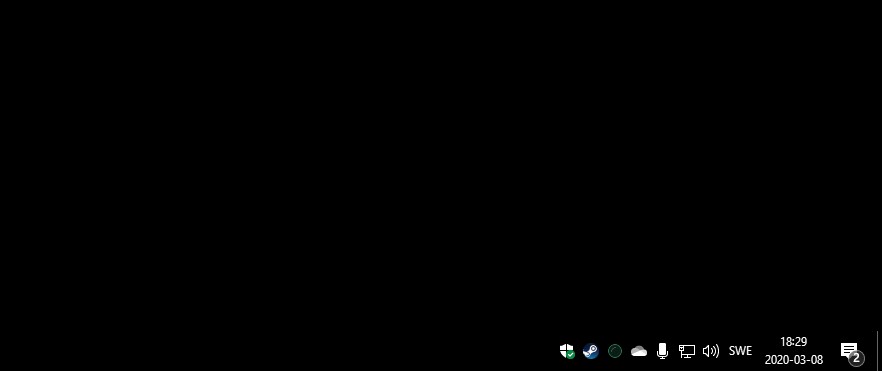

    Hello.
    I'm having a real frustrating problem with color accuracy/picture quality.
    Maybe I'm missing something obviuos but I have trawled the internet for answers.
    My setup:
    • Windows 10 updated
    • Nvidia 980ti
    • Acer XB270HU -Displayport
    • ASUS VG258 -Displayport
    • 442.50 drivers also tested a couple of older ones, usually don't update more than once a couple months
    Without any drivers installed after DDU/format C-drive both monitors have a great black contrast and good colors.
    But directly after Nvidia Driver installation even before a restart everything gets really washed out and stays bad.
    Why is this happening and can I disable/remove whatever is happening at the end of installation?
    I had this computer for several years except sec monitor which is a little newer and everything worked great.
    Recently bought two new displayport cables for the monitors to test, Asus ran on a HDMI connection before.
    Washed out monitor colors after Nvidia driver install e5e0440c-764b-41f5-bc9b-9f30f959ba77?upload=true.jpg Washed out monitor colors after Nvidia driver install 2e6bf12c-bb36-4ee5-a391-f767f5f1611a?upload=true.jpg
    https://imgur.com/a/WB58jb1?&nc
    Tried taking screenshots of my problem and if I can do that it must be a software problem?
    Did something change in Windows or Nvidia driver recently that can do this?
    Steps I have tried to troubleshoot:
    • x-rite i1 colorimeter to check if my eyes are deceiving me and generate icc-profiles
    • Nvidia control panel settings, check the cable signal full-limited range. was Full both monitors.
    • Disabled Windows services "Display Policy Service", Display Enhancment Service"
    • Removed checkmarks for "Use Windows Calibration" in Control Panel
    • Disabled the "Calibration Loader" in "Task Scheduler"
    • Removed drivers with DDU prior to test older ones
    • Full format of C-disc and reinstall of latest Windows 10 version
    • Removed all my saved user settings in OneDrive account
    Thanks for taking the time reading.
    Hopefully it's fixable.
