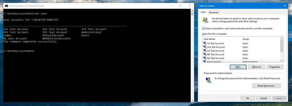

    Based on the screenshot that you have provided, when you run net user command, it displays all the accounts in the system, including the default account, administrator and guest and your user accounts. However, this is displayed in alphabetical order
    and in columns of three.
    In the below screenshot, I have created the 5 test accounts and this is displayed on top as per the alphabetical order.
    If you type netplwiz command in Windows Search, you will see the User Accounts window which shows all the user accounts that you have created and can login to.
    WDAGUtilityAccount  displayed via net user with my username, and my Default Account as... d327e418-de62-45e5-9fcf-1eac2058a6ec?upload=true.jpg
    If you need full information on the user accounts on your system, you can run the following command in the command prompt.
    wmic useraccount list full
    We await your response.
