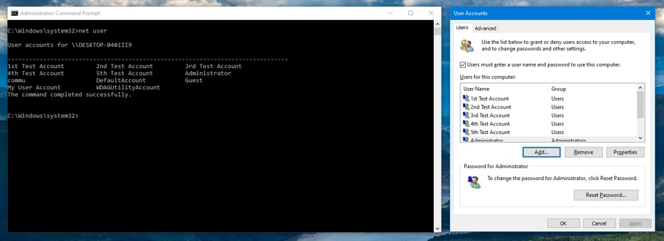

  2. WDAGUtilityAccount
    We understand your concern regarding the WDAGUtilityAccount and we will certainly help you with the information.
    WDAGUtilityAccount is part of Application Guard beginning with Windows 10 version 1709 (Fall Creators Update). This account remains disabled until Application Guard is enabled on your device. This item is integrated to the OS and is not
    considered as a threat/virus/malware.
    There are multiple system accounts that are built-in to Windows and WDAGUtilityAccount is one of them.
    Based on the screenshot that you have provided, when you run net user command, it displays all the accounts in the system, including the default account, administrator and guest and your user accounts. However, this is displayed in alphabetical order
    and in columns of three.
    In the below screenshot, I have created the 5 test accounts and this is displayed on top as per the alphabetical order.
    If you type netplwiz command in Windows Search, you will see the User Accounts window which shows all the user accounts that you have created and can login to.
    WDAGUtilityAccount  displayed via net user with my username, and my Default Account as... d327e418-de62-45e5-9fcf-1eac2058a6ec?upload=true.jpg
    If you need full information on the user accounts on your system, you can run the following command in the command prompt.
    wmic useraccount list full
    We await your response.

  3. Bree Win User
    WDAGUtilityAccount
    WDAGUtilityAccount and DefaultAccount are not replacing your user account, they are in addition to any other user accounts. They are necessary for the system to operate normally. DefaultAccount is a template for creating new user accounts and WDAGUtilityAccount is stated by the system to be "A user account managed and used by the system for Windows Defender Application Guard scenarios."
    Neither account is active, nor should they be made so. Both accounts are managed by the system and should be left alone.
    WDAGUtilityAccount  displayed via net user with my username, and my Default Account as... [​IMG]
    There are other system accounts besides these two. Open a command prompt and type NET USERS
    The names will include: Administrator, DefaultAccount, Guest and WDAGUtilityAccount. A Pro system running Hyper-V will also include RDV GRAPHICS SERVICE. Any other names will be your normal user account or accounts.
