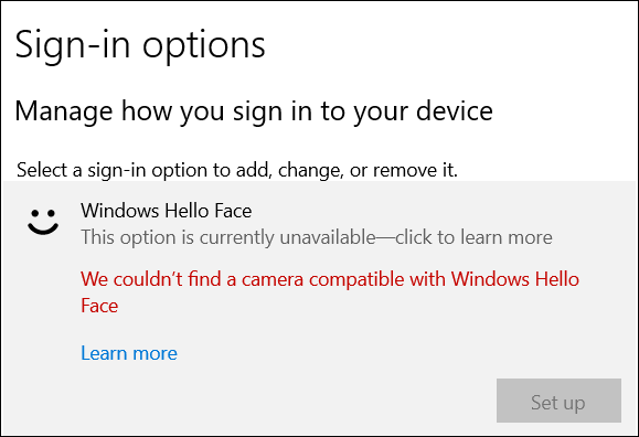

  1. We Couldn't Find a Camera Compatible with Windows Hello Face
    I've seen several threads on this issue, which I'm now encountering on my new PC. Can someone help? I've spend the last hour or so trying the various recommendations to no avail. I'd just like to remove it altogether if this is no longer available.
    I'm on Windows 10 Pro and my PC Info is as follows: DELL XPS 13 7390 2-in-1
    We Couldn't Find a Camera Compatible with Windows Hello Face 9df7907d-3037-4dc2-8334-4d252f39207e?upload=true.png
    AKayCookie, Jul 9, 2020

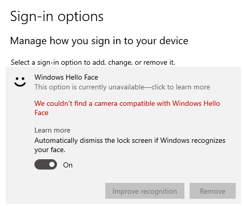

  3. Wienen Win User
    We couldn't find a camera compatible with Windows Hello Face
    Dear all,
    When i first booted my Surface Laptop 3 the Windows setup didn't include the setup of Windows Hello Face.
    After completing the setup and manually trying to configure it from the settings menu i'm prompted with the following error;
    "We couldn't find a camera compatible with Windows Hello Face"
    We Couldn't Find a Camera Compatible with Windows Hello Face 00c6f3a2-956a-4fdc-a28b-9624985cea55?upload=true.png
    After doing some research i found the "Windows Hello Face Software Device"
    and therefor also the category "Biometric Devices" are missing withing Device Manager. Searching for new/changed devices didn't help.
    I've tried updating Windows to the most recent version (1909) and installing the latest Surface Laptop 3 Drivers/Firmware (Nov release) didn't bring back this hardware. Even a factory reset from within Windows didn't fix the problem.
    Finally after a lot of research and trail/error i found the solution which i wanted to share if someone else is having the same issue.
    see reply so that can be marked as Answer...
    Wienen, Jul 9, 2020
