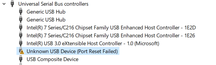

    Webcam and Touchscreen are not working , Basically both the device are not showing in the Device manager .
    Tried different options like below :
    1. Reinstalled the window
    2. Updated the window
    3. Checked the device driver on the device page https://www.dell.com/support/home/en-uk/product-support/product/xps-12-l221x/drivers the touchscreen driverAtmel Touch Screen Firmware Update is available for window 8 and 8.1but not available for Windows 10 .

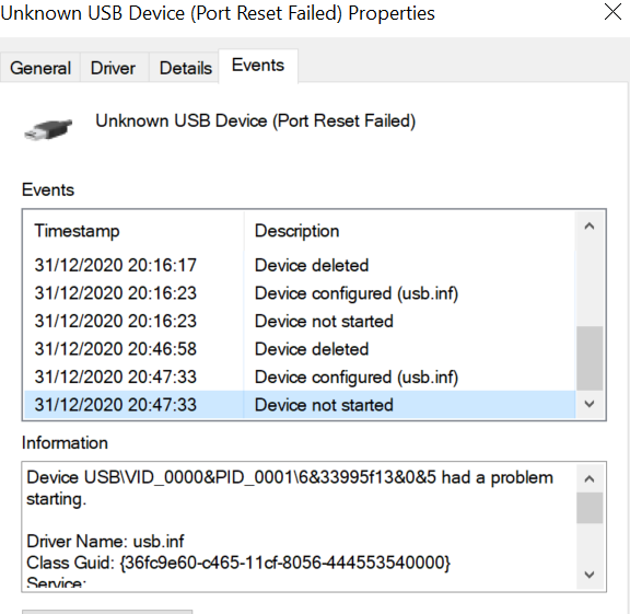

    4. One of the USB device is failed in device manager . Error is like Windows has stopped this device because it has reported problems. Code 43.

    Tried to remove and reinstalled it but still the same issue .
    Webcam and TouchScreen are not working in Dell XPS 12 9Q23 laptop a1f79473-ef59-4618-8b13-65441754e667?upload=true.png
    Most probably because of USB issue causing Webcam and touchscreen problem . Full logs could be provided if required .
    Any help related to finding the compatible Window 10 driver for the product or fixing the usb.inf issue will be appreciated.
