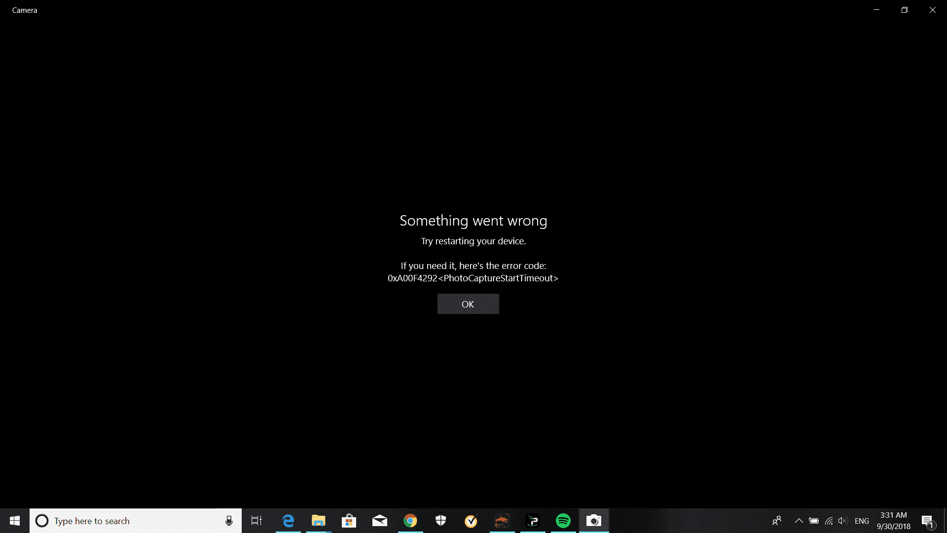

    Hi All,
    I've read several threads on webcam issues and it all seems to be related to the constant updates. The latest error I'm getting is attached. When I check my driver details, it states my built-in webcame is now a USB video device (version 10.0.17134.1). I've verified all of my privacy settings are enabled for both webcam and microphone (as previous threads suggested that). My notebook is brand new and purchased just last week. I've already reported this to the manufacturer (MSI) and thus far, they've not been able to diagnose further. The webcam function is enabled via Fn+F6. If anyone knows of a fix for this or can suggest other troubleshooting tips, please post for all. I'm hanging on by a thread but honestly I will likely exchange this for a Mac as I hear Macs don't crap up as often as Windows. Any suggestions there too? Thanks a bunch! Webcam Issues 4c051ca2-3064-4d46-9afd-7eab94d1c0b2?upload=true.png
    RogueGnome85, Sep 30, 2018

    Thank you for posting on Microsoft Community. I understand the inconvenience you are facing. I will certainly help you with this.
    The information which you have provided is not enough for us to determine the issue. Please provide us more information.
    • What exact error message do you receive while using Webcam?
    • Does this issue persist while using specific app/program or does it persist with all app using Webcam?
    Method 1:
    I suggest you to run the Hardware and Devices
    troubleshooter and check if it helps.
    • Type troubleshooting in the search bar.
    • Select Troubleshooting.
    • Select View all on the top left corner.
    • Click on Hardware and Devices.
    • Follow the on-screen instructions to run the troubleshooter.
    • Check if issue persists.
    Method 2:
    If issue persist, I suggest you to try installing Webcam drivers in compatibility mode. Compatibility mode runs the program using settings from a previous version of Windows. Follow these steps to install the drivers in compatibility mode and check
    if that helps.
    • Download the Webcam drivers from the manufacturer’s website.
    • Right-click on the driver setup file and click on ‘Properties’.
    • Click on the ‘Compatibility’ tab and check the box
      ‘Run this program in compatibility mode for’
      and select Windows 8/8.1 operating system from the drop down menu and proceed with the installation. Once this is done, restart the computer and check if the issue persists.
    Hope this information is helpful. Do reply if you need further assistance, we will be happy to help you.
