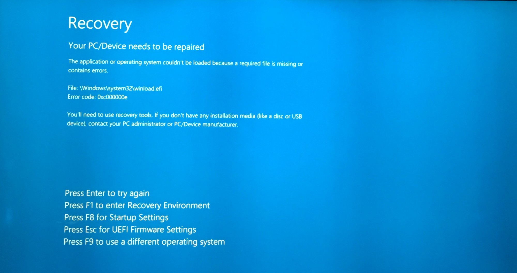

    I had Windows 10 1803 installed on a HDD in an HP OMEN notebook. I installed a PCIe SSD. I used a bootable USB with Windows 10 1903 (from the Media Creation Tool) to install 1903 on the SSD and produce a dual-bootable setup.
    I have been experiencing what I think is a weird boot error.
    Upon booting (before any splash screen) I receive the error pictured below:
    Weird Dual-Boot Startup Error 08681657-9f5b-4b20-a435-248b0aa2cd94?upload=true.jpg

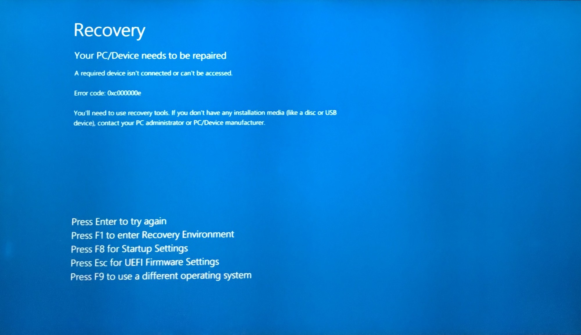

    Pressing ENTER produces the error below:
    Weird Dual-Boot Startup Error b3d1782a-cfb1-4c6d-8a5a-c6b4af3a90e6?upload=true.jpg
    I can eventually boot to either drive using several combinations from the options on this error-screen, but here's what I want to point out:
    I can boot without either of the errors pictured above as long as I enter the BIOS immediately at startup.
    If I press ESCAPE immediately at startup (entering the BIOS menu) and then press ENTER to continue with startup (exiting the BIOS menu), the OMEN splash screen appears, the dual-boot-selection screen appears, and startup proceeds normally, without errors.
    How can I fix these errors? Hopefully, the description of the procedure above is informative.

  4. topgundcp Win User
    Dual Booting with Windows 8.1
    The procedure below will allow you to boot Windows separately or in dual boot configuration.
    Here's what I recommend to do:
    1. Disconnect the drive containing Windows 8.1
    2. Install Windows 10 with one drive connected.
    3. After step 2, reconnect the drive containing Windows 8.1
    4. Boot up Windows 8.1. Open disk management and take a note of the drive letter of Windows 10 OS.
      NOTE: if you boot up Windows 10, then take a note of Windows 8.1 drive letter
    5. Open Admin command prompt and type: bcdboot X:\windows where X: is the drive letter of Windows 10 (Windows 8.1 if you boot from Windows 10 in step 4)
    6. Reboot the PC. You should have a dual boot screen.
    NOTE: To break off the dual boot setting, Win+R->msconfig->boot and delete the none default entry on the list.
    topgundcp, May 29, 2019
