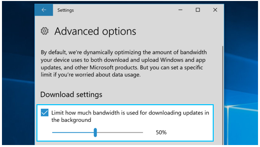

  4. What is svchost.exe NetworkService -p, and how do I stop it using all my bandwidth?
    svchost using all of bandwidth
    Svchost is essential in the implementation of so-called shared service processes, where a number of services can share a process in order to reduce resource consumption. To resolve your issue, we recommend setting a bandwidth limits for background downloads.
    To set a bandwidth limits:
    • First, select the Start, then select Settings.
    • Then, Update & security, then Advanced options.
    • Select Delivery Optimization.
    • Choose Advanced options.
    What is svchost.exe NetworkService -p, and how do I stop it using all my bandwidth? dc790e8f-3e9e-4ac6-8036-d0a4da78272d?upload=true.png
    Select Limit how much bandwidth is used for downloading updates in the background. Then use the slider to set the percentage of available bandwidth used for background downloads. Lower values use less bandwidth but cause updates to be delivered
    more slowly.
    Marvelos Reg, Apr 8, 2020
