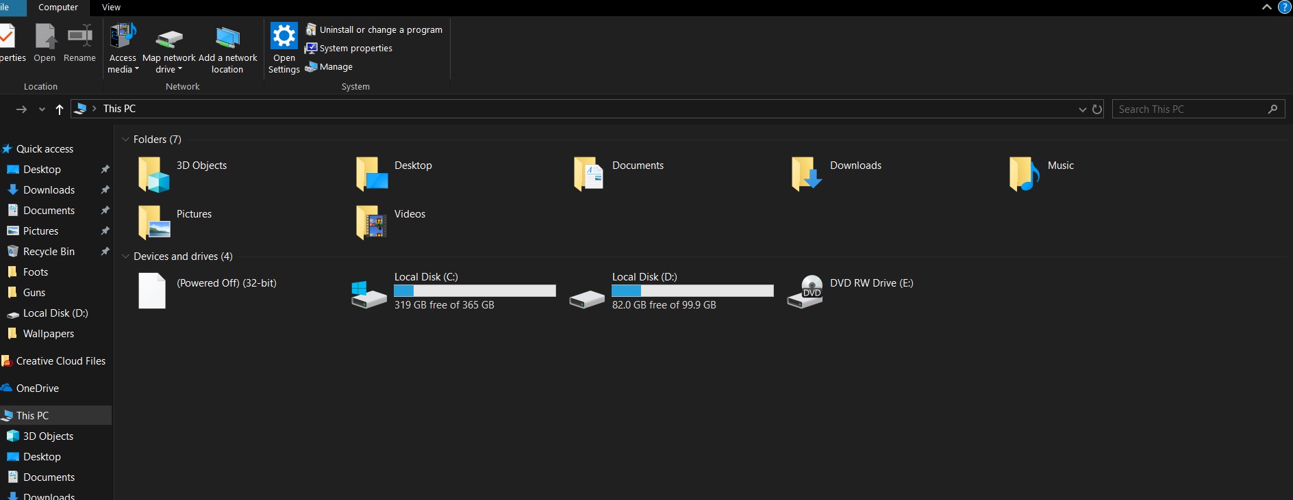

  1. What is this (Powerd off)(32 bit) in my file explorer
    What is this (Powerd off)(32 bit) in my file explorer 3eac4325-f215-421c-8711-ba5cfb552a8a?upload=true.jpg What is this Powerd off(31 bit) in my file explorer
    SAMIREHMAN2, Dec 10, 2018

  4. What is this (Powerd off)(32 bit) in my file explorer
    How do I find the 32 bit Internet explorer?
    Hello Lady,
    Thank you for posting your concern in Microsoft Community and welcome to the Windows 10 Family.
    From the description provided, i understand that you want to use the 32 bit version of Internet Explorer.
    Please be informed that you will find ‘Program File’ folders that are listed for 32 bit and 64 bit version of Windows under C: drive. The folder with (x86) is for 32 bit version of programs/applications.
    One of the better uses for having two seperate folders is that you can have both 32 and 64 bit versions of the same application installed at the same time. And, it is here, that you will find the Internet Explorer for 32 bit version to use.
    Hope the above information is helpful. If you need further assistance, we would be happy to help you.
    Thank You.
    Sayan_Ghosh, Dec 10, 2018
