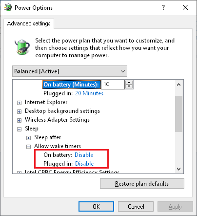

    I already did this:
    What to set in UpdateOrchestrator if it wakes up my laptop from sleep in the midnight? 7538bfc7-04d8-46ea-bea5-4ff30bbc20fa?upload=true.png

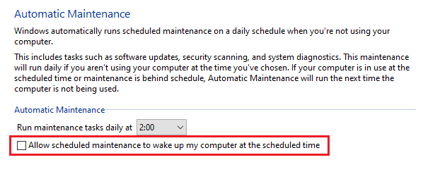

    this was already unchecked:
    What to set in UpdateOrchestrator if it wakes up my laptop from sleep in the midnight? c3fc2435-2c0a-4759-a278-17791f923e91?upload=true.png

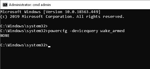

    I removed all the devices from the list, so it's empty:
    What to set in UpdateOrchestrator if it wakes up my laptop from sleep in the midnight? 1c7bdfae-176b-4e78-81cd-10da0bfcec32?upload=true.png

    I suggest you to check which devices are configured to wake up the computer from sleep by following the steps below:
    • Right click on Start icon and select Command Prompt (Admin).
    • Type the command line below:
    Powercfg /devicequery wake_armed
    3. Check if the devices (Keyboard, Mouse, Ethernet cable) are listed.
