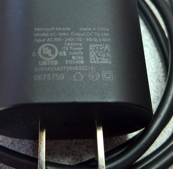

  4. whats the correct charger for microsoft 950
    Lost charger for Microsoft 950
    I'm sure my charger is the same as your charger.
    The key is that it is:
    output DC 5V 3.0A
    Input 100-240 v 50-60Hz 0.40A
    Just as an FYI, my charger is Model AC 100U
    whats the correct charger for microsoft 950 fea239f2-1953-4ab2-8d78-e586120db372.png
    This charger has the cable as a permanent part of the part that plugs into the AC outlet. Using a USB-C cable and an AC adapter will give you the same result. It will charge the device but the added bonus is you can also charge off of a laptop or other powered
    USB output (similar to what you nor see on AC wall plugs).
    Keep in mind that mine was with the 950XL but I maintain that it would charge your 950 perfectly and that the replacement I linked above in a previous reply should do the trick for you. If you can find the same power adapter that would be good but usually
    it is difficult to get the exact one.
    I did see it on ebay:
    OEM Microsoft Ac-100u Type C Wall Charger LUMIA 950xl for sale online | eBay
    This link shows what I was describing (USB-C cable and wall adapter) that supposedly is Microsoft 950 original.
    https://www.ebay.com/itm/Nokia-Orig...311105?hash=item3d53587501:g:mgAAAOSw3WxaNaJ0
    And this one on Amazon:
    https://www.amazon.com/Nokia-Origin...=1514486064&sr=1-3&keywords=nokia+950+charger
    If you got the plugin type they can vary in output 1, 2, 3 amps. Look at the specs
    Jack Cook - aka Help_Line, Jul 24, 2019
