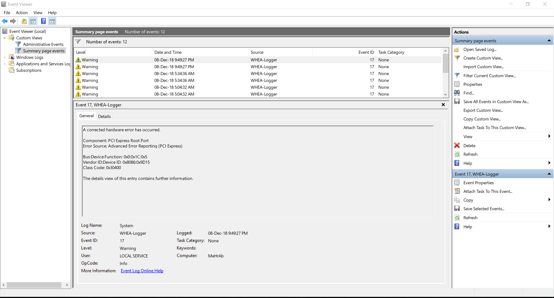

  1. WHEA-Logger event ID 17, Windows 10
    i'm using "ASUS Vivobook 15 X542UN" Laptop.And in event viewer. i can see that there is as warning showing me which is WHEA-Loger Event ID 17.
    and i need proper and absolute solution about that warning.please resolve my problem as soon as you can.and confirm me if i need to go to
    Customer care Support.
    Doing Command promt command:---- https://drive.google.com/open?id=1vISwkLdmhczC1zar-aMUSVHH2bWM0mpq
    CBS Log:-- https://drive.google.com/open?id=12k2s8EIIL4X59sUYMd9xiGg8n-YxFJq2
    WHEA-Logger event ID 17, Windows 10 c360ba66-03da-449a-a987-46c2343be65c?upload=true.png
    Mohammad Mehrab Hossain, Dec 8, 2018

  3. WHEA-Logger | Event ID 17 Issue
    Lots of people with HP laptops latest 2017 releases have the same error WHEA logger event id 17 and I have that too.....
    The WHEA logger error causes freezing whole laptop creating an error in event viewer
    Tried some settings in advance power settings
    Changing "Maximum Power savings" to "off" in PCI Express ----> LInk Power state management this fixed the error for a while but now i have spotted the error in every latest laptop that has Nvidia Geforce 940 mx graphic card
    my laptop is
    HP Pavilion x360 14-ba073tx and the same error was also repeated with my friends
    Hp Pavilion 15-cc102tx
    Can you help me ASAP
    And also please explain in detail how to disable "WHEA logger error" as you done above
    Thanks in advance
    VENKATA RAJUPUTRA, Dec 8, 2018
  4. Tima777 Win User
    WHEA-Logger Event ID 17 flooding System Events
    Good day!
    I've got the same problem with this laptop model ASUS X555UB.
    Source: Microsoft-Windows-WHEA-Logger
    Date: 07.02.2016 20:17:19
    Event ID: 17
    Task Category: None
    Level: Warning
    Keywords:
    User: LOCAL SERVICE
    Computer: DESKTOP-5C70LDP
    Description:
    A corrected hardware error has occurred.
    Component: PCI Express Root Port
    Error Source: Advanced Error Reporting (PCI Express)
    Bus*Big Grin WHEA-Logger event ID 17, Windows 10 :Device:Function: 0x0:0x1C:0x5
    Vendor ID*Big Grin WHEA-Logger event ID 17, Windows 10 :Device ID: 0x8086:0x9D15
    Class Code: 0x30400
    I updaded all drivers, installed all updates for windows 10, checked the latest drivers from ASUS, updated BIOS. Nothing helped to avoid this WHEA problem. I wrote to ASUS support, still waiting their answers but I am not sure that they will give useful information how to deal this it. Did you have a chance to fix it thus far,
    satindemon4u?​
    Tima777, Dec 8, 2018
