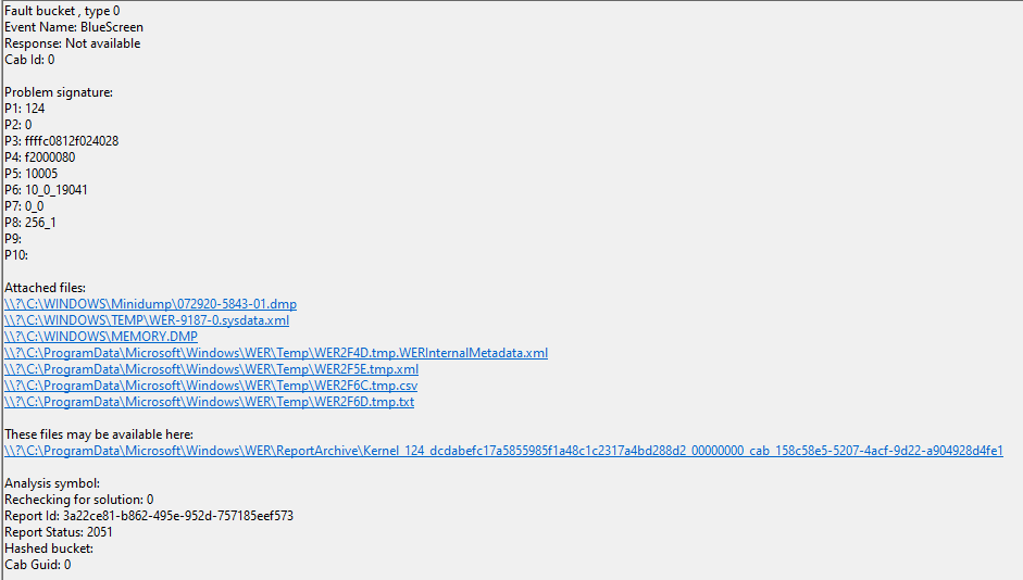

    More Information from Event Viewer:
    WHEA_UNCORRECTABLE_ERROR ad3c5e15-d8af-4bf0-ae20-cfb9f1e3eb1f?upload=true.png
