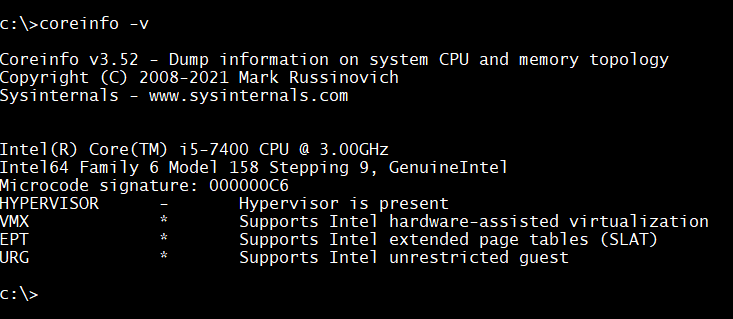

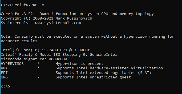

    recently I created a windows 10 pro virtual machine inside a windows 10 home OS using virtual box. I found that windows 10 pro has built in hypervisor called hyper-v. I have nested visualization turned on in virtual box and my processor also support it. I made a windows 8 virtual machine in it but it gives an error saying that one of the hyper-v components are not running. So I went to windows features and tried to turn on hyper-v hypervisor. However it is greyed and the description says I can't turn on because my processor doesn't have SLAT capabilities. I have it of course.
    Here is what I got running core info in the virtual machine.

    And here is what I got running coreinfo in the host.
    why can't I run hyper-v inside virtualbox 34af61a1-2ab8-424f-adfa-14f7dc4f1832?upload=true.png
