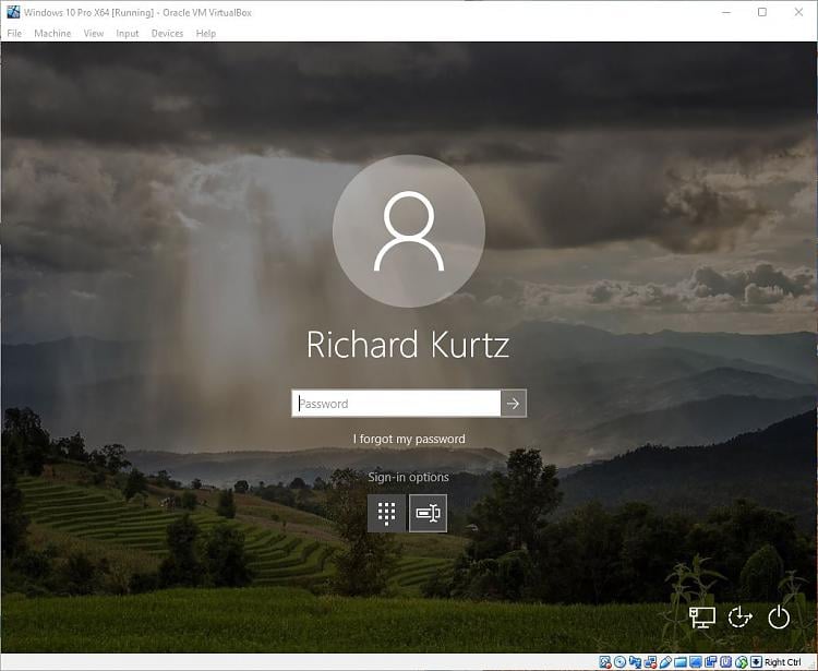

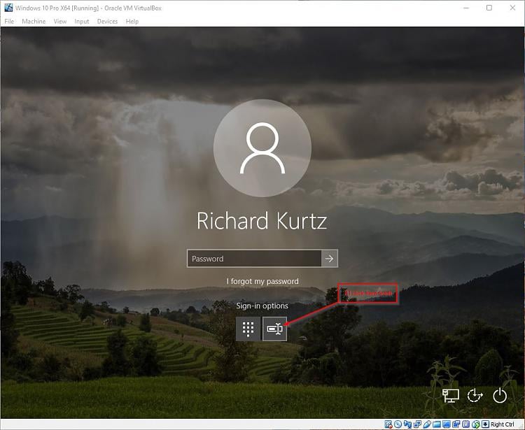

    (A) If clicking at the Microsoft Account box on the right first > sign in with the password > it will go to desktop without prompting for Pin create.
    (B) If entering the password into the password box right away without clicking at the Microsoft Account box first, then create Pin prompt will appear.
    That registry editing tutorial ( A Workaround to Disable PIN Login in Windows 10 / 8 | Password Recovery ) is not necessary. I can keep the "value" at 1 and still be able to avoid prompting to create PIN if I use method (A)
