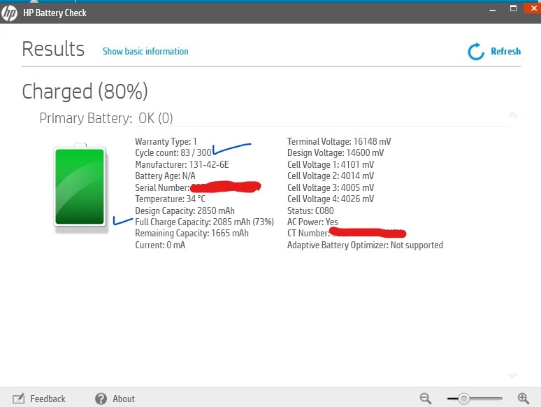

    Hello there, My laptop has completed its 3 years and now its facing problems regarding power.
    Now, its battery doesn't charge beyond 73% normally, if I want it charge it more then the laptop takes hours to reach beyond 90%
    What can be the issue? Please help me to know about it.
    Thanks
