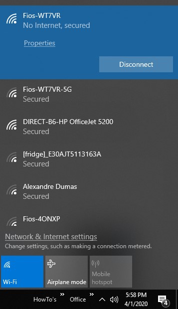

    Why my wifi internet status changes to no internet, secured when I connect VPN?
    Why my WiFi internet status changes to no internet, secured when I connect VPN?
    Why my wifi internet status changes to no internet, secured when I connect VPN? ea550aaa-5a6a-4647-bcde-bcc1865cbc6e?upload=true.jpg
    Second my WiFi icon changes to LAN connection icon, is that normal? What does it happen?
    Why my wifi internet status changes to no internet, secured when I connect VPN? a96d32c7-f52b-4110-85d5-f210a5d8cd3f?upload=true.jpg
    Just trying to understand this behavior of Windows
    jackin, Apr 1, 2020
