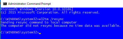

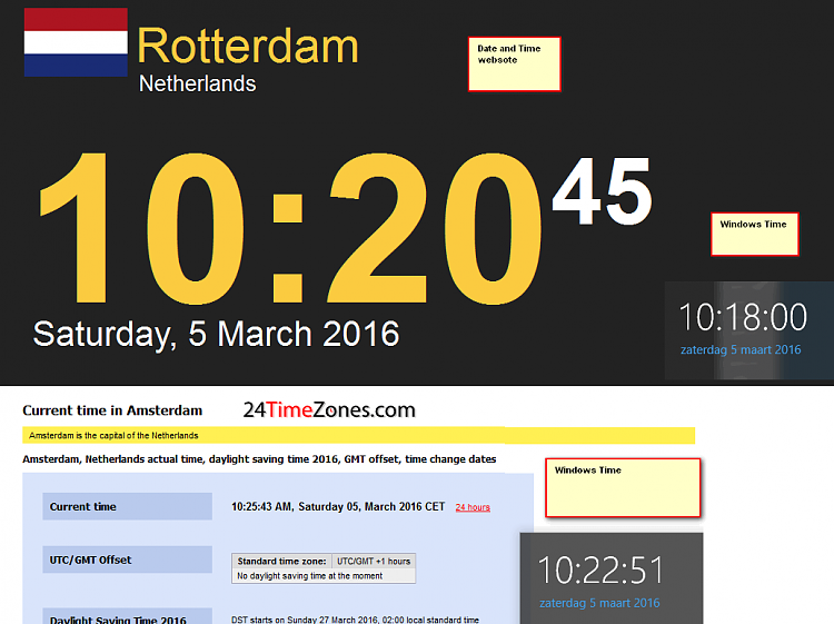

    With me the Windows time is about 2-3 minutes off.
    I did try to resync
    Control Panel\Clock, Language and Region->Tab Internet Time change settings
    using both time.windows.com and time.nist.gov
    no change
    then w32tm /resync
    then set services.msc windows time->automatic
    still no change.
    didn't go thru the steps of Joanne: would not know where to find this 'SpecialPollInterval'-thing.
    discovered this 'wrong windows time' as I normally set all clocks and my wristwatch to Windows.
    Updated all times when changing from Feb. 29 to march 01 and started missing the news on the radio and tv.
    Will not be using Windows time anymore.
