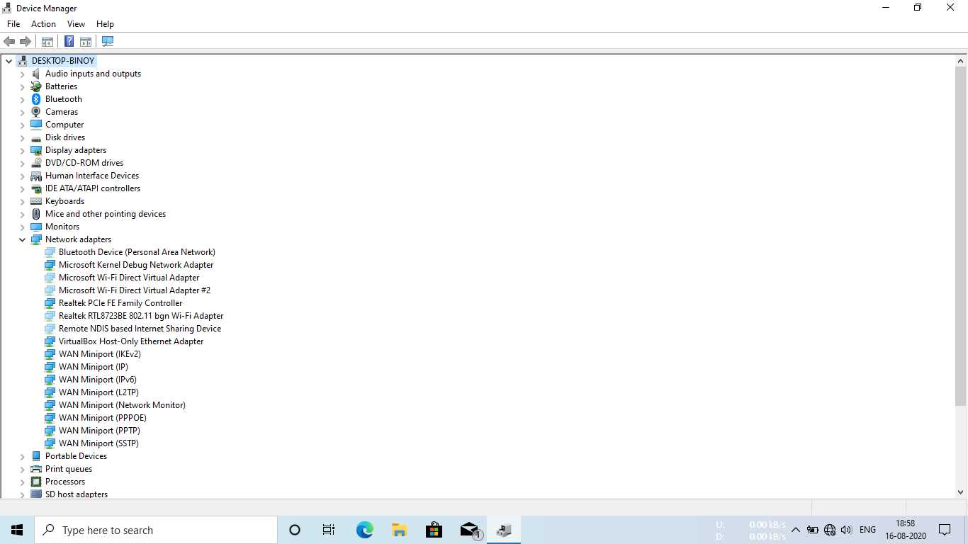

    If I go to 'show hidden devices' tab the wifi adapter is in there but greyed.
    WiFi Adapter Disappeared 2fbdb946-d4e4-4dac-ae07-7e1f8853a10f?upload=true.png

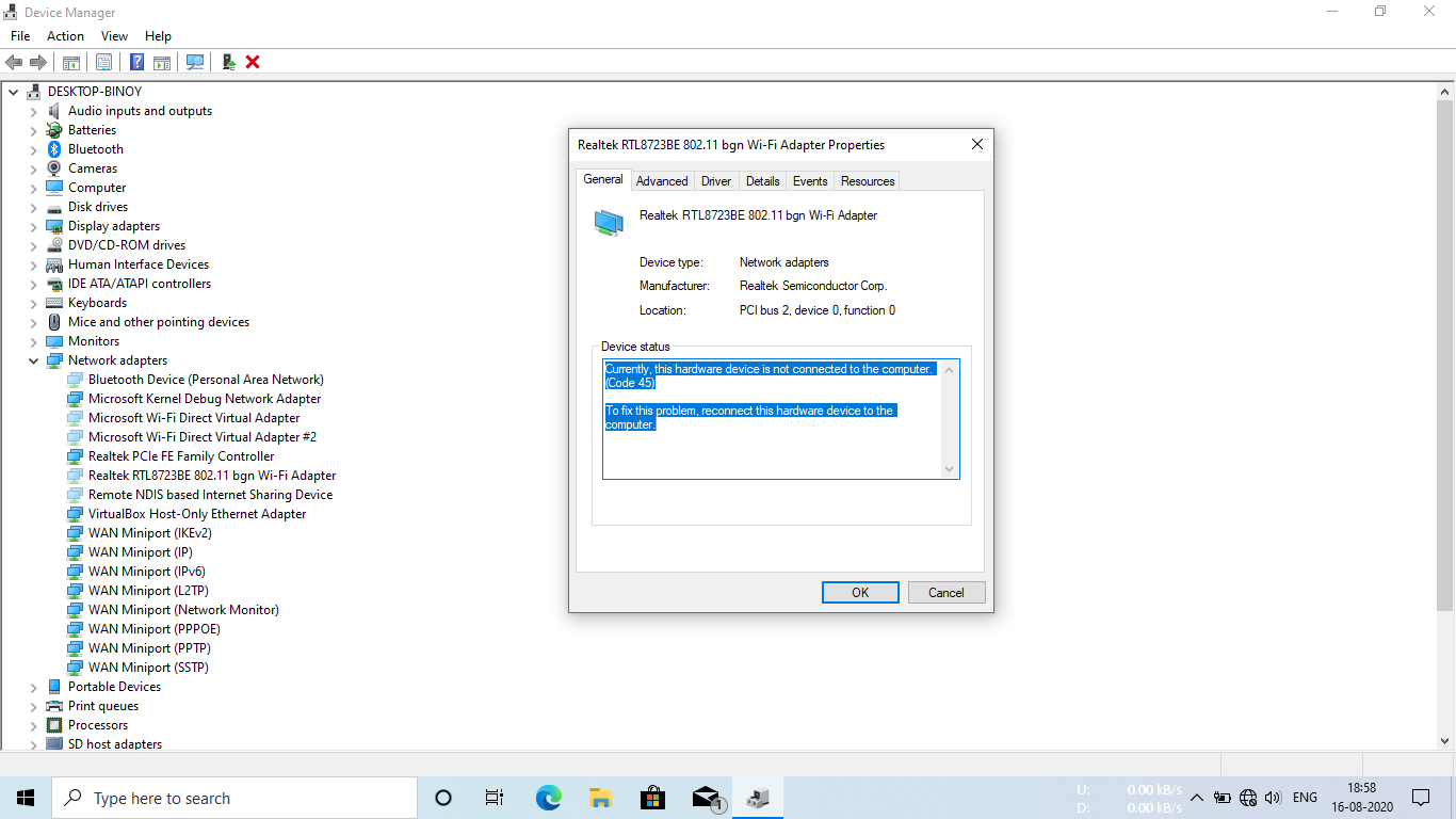

    Then I go to properties tab and got this error as shown in this bellow screenshot. Code 45 and suggest me to reconnect the device to the computer. What does it mean?
    WiFi Adapter Disappeared 22df932d-2080-4b43-9bcd-1987131d64bb?upload=true.png
