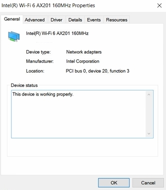

    Issue: When waking up from sleep, Wifi is disconnected. Checked in NCPA.CPL network connections that WiFi adapter has disappeared. Wasn't able to check in device manager. User have to restart to fix issue.

    1. Checked that the Network adapter doesn't have the Power Management Tab.
    WiFi Adapter disappears after waking up from Sleep 8590e045-60ff-4dc3-ad45-1c85b768ed63?upload=true.jpg
