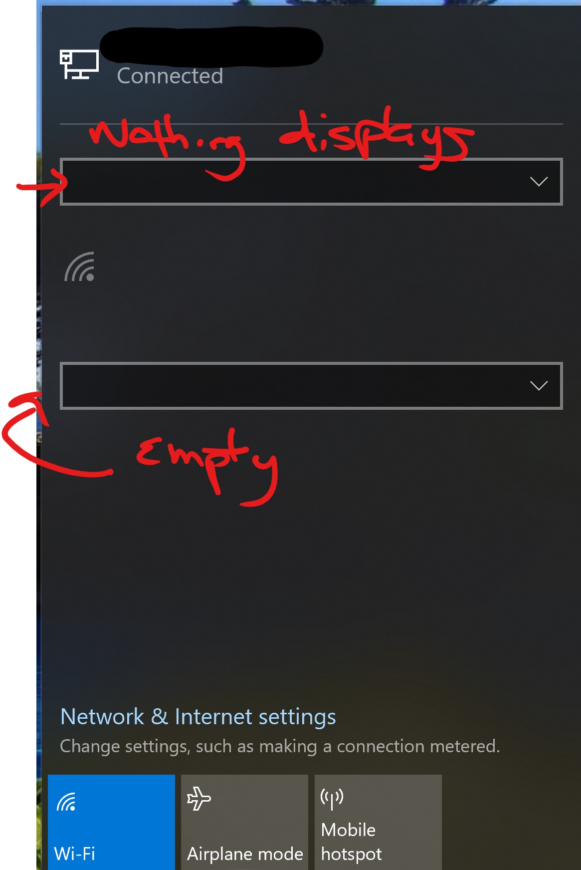

    Hi all,
    I have seen that this has been asked many times but have not seen a clear answer.
    Thank you in advance for valid urls to solutions.
    Here is a screenshot of my issue:
    WIFI networks UI disappears 931a88bb-47ad-4b89-97da-c0b68e4432e7?upload=true.jpg
    Nathan ALS, Feb 6, 2020
  2. Bree Win User
    WiFi appears in Manage Known Networks, not in Show Available Networks
    The list of WiFi connections shown when you click the WiFi icon in the taskbar is a list of all the signals that can currently be seen by the WiFi adapter. The list in Manage Known Networks is a list of all those you have previously successfully connected to, whether or not they are currently available.
    The only plausible explanation is that for a while that WiFi signal had been turned off.
    Bree, Feb 6, 2020
  3. Wifi disappears from abailable networks
    We suggest you to run the Network Troubleshooter to check if what is causing the issue. To do that, follow the steps below:
    • Click Windows icon.
    • Type Troubleshooting.
    • Click Network and Internet.
    • Click Internet Connections.
    • A box will open, click Next to proceed with the troubleshooter.
    If the issue still persists, you may get in touch with your device manufacturer to check for updated driver.
    Let us know how it goes.
    Jesebel Ova, Feb 6, 2020
