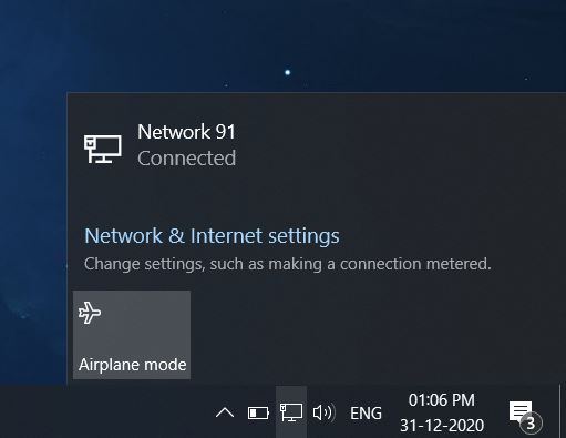

    I even tried to update my driver. Tried troubleshooter. Restarted multiple times. Even restarted the wifi adapter via powershell. None of the methods worked. Initially when I start windows the Wi-Fi option is visible but when I click the button it disappears. The image is below:
    Wifi option not available in both taskbar and inside settings after windows update. Network... ea8a1211-af1e-4cfd-a4e1-1ce5e23399e5?upload=true.jpg

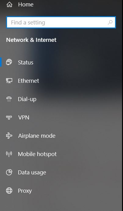

    I then went to Settings>Network and Internet> Wifi , switched the wi-fi on and after a few seconds the wifi section disappeared
    Wifi option not available in both taskbar and inside settings after windows update. Network... 05be5044-eb0d-4692-8108-0e102ef59cae?upload=true.jpg

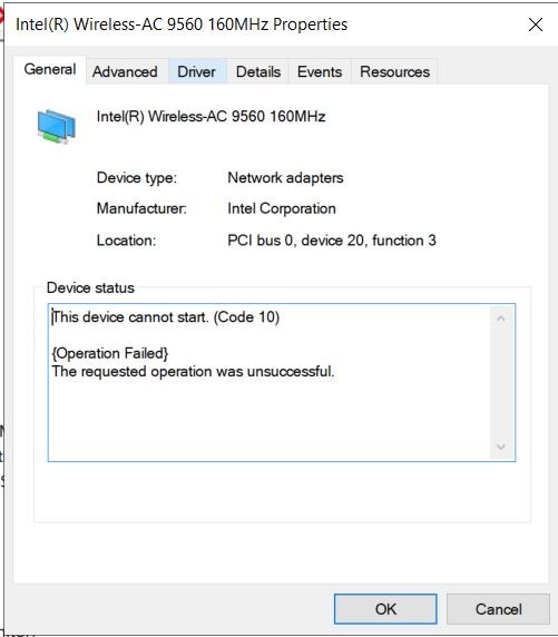

    I then looked at the network adapters - it shows code 10 error
    Wifi option not available in both taskbar and inside settings after windows update. Network... 34899701-98ed-493f-adda-0755f2f298de?upload=true.jpg

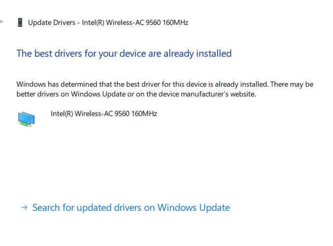

    So I tried to update the driver:
    Wifi option not available in both taskbar and inside settings after windows update. Network... 07ebf419-b042-4781-b8ef-1726848d373f?upload=true.jpg
    But it says the driver is up-to-date.
